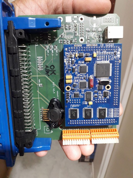

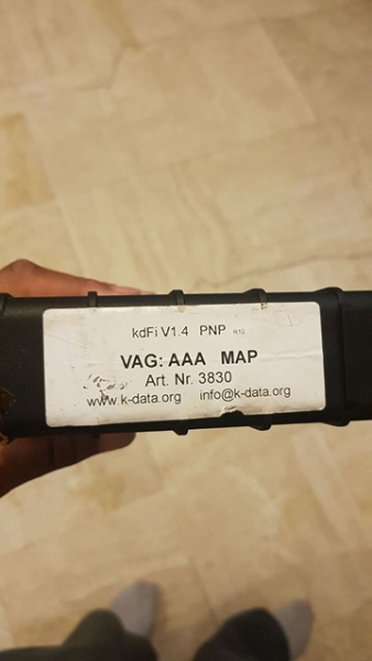

I am contacting you for information on Kdfi equipment.
I bought a kdFi V1.4 PNP VW AAA calculator (VR6) but I have a problem to start the engine (Golf 3 vr6 turbo).

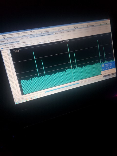

Indeed, I am in wasted spark like this :
http://www.strperformance.com/4625-larg ... 8l-29l.jpg
Does it work too or does it absolutely need the ABV kdfi?
With the original vr6 OEM calculator the car starts without problem so it is not a problem of setup.
The sensor Vr/hall is new (same pb)
Thanks for your support (in english please or i traduct with google). :idea:

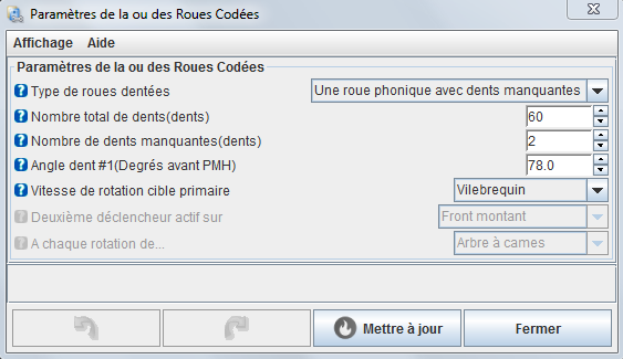

Which pattern does your trigger wheel have? The second peak indicates a second gap. Is it really a x-1-1 or a more conventional x-1 wheel?
Regards
Zuletzt geändert von Dominik335i am Do Jan 25, 2018 11:36 am, insgesamt 1-mal geändert.

Yes, but this does not answer my question ;-) Is it a 60-2, 36-1 or what ever trigger wheel? The tooth logger must correlate with the pattern.
In case of a 60-2 wheel it should look like this:

60-2
Re: Vr6 turbo with Kdfi v1.4 PnP
Then you have to sort out your trigger issues! Is it a hall or vr sensor at the crank?

It's essential to have a proper tooth logging. You have to sort out the trigger signal issue and clarify the reason for the second spike. Everything else is a waste of time.
Once you have a proper signal and everything is wired up correctly, the engine will start with no doubt after some tweaking...

I searching why i dont have a good signal, is my question ..

I will try to inverse VR+ and Vr- somebody has tested that ?
Just try it ;-) Do you have access to an oscilloscope?

To check the "raw" signal of the VR sensor?! :roll:
